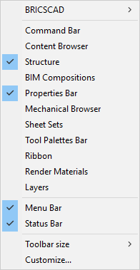

To open or close a panel
Move the cursor over a toolbar or ribbon panel,
then right click.
A context menu displays.
Panels that are currently open are checked.
Click a panel in the menu to toggle its display.

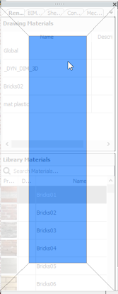

To dock a panel with respect to another docked panel
When another panel is already docked, you can dock another panel at the top, bottom, left or right of the docked panel or add the panel as a tabbed panel.
Drag the panel by its title bar over a docked
panel.
The docking location selector displays. The blue zone indicates the
selected docking position with respect to the docked panel.
Move the cursor over the top, right, bottom, or left side of the docking location selector to choose the docking position with respect to the already docked panel and click when the appropriate position highlights.

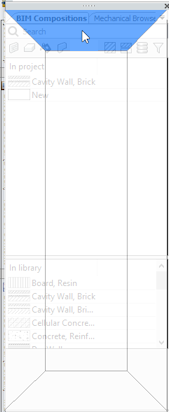

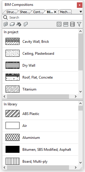

To stack panels in a tabbed panel
Panels can be grouped into a tabbed panel. A tabbed panel can be either docked or floating.
Drag a panel by its title bar.
Move the cursor over the center of the docking location selector to add the panel in a new tab.

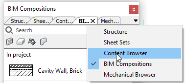

Using tabbed panels
Do one of the following:
Click the panel tab.
Pause over a tab to display a tooltip.
Click the down arrow button, then select the
panel in the list.
