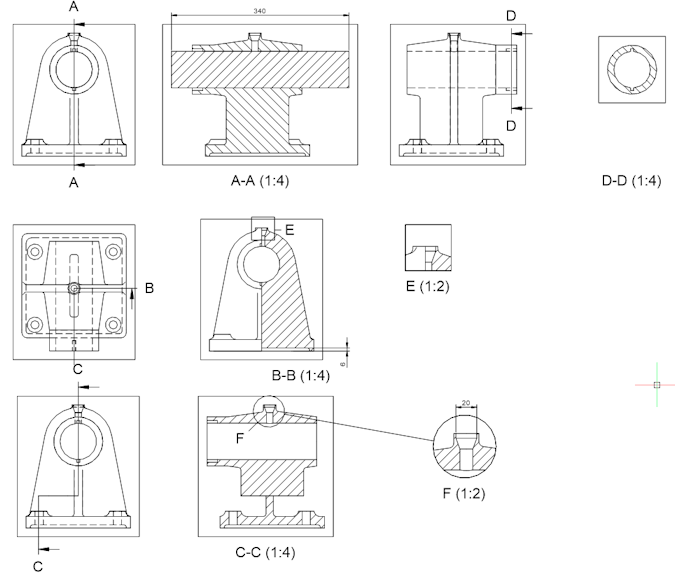

The ViewSection command creates a cross section view based on a standard drawing view generated by the ViewBase command in a paper space layout.
The ViewSectionStyle command allows to modify the appearance of the section views created by the ViewSection command.
The ViewProj command generates additional projected views from an existing generated drawing view.
The ViewDetail command creates a detail view of a portion of a standard generated drawing, at a larger scale.

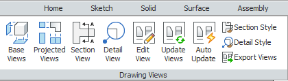

Tools to generate drawing views of your 3D solid model are available on:
The Drawing Views toolbar, which is a flyout of the View toolbar:
The Section Types and Detail Section Types toolbars:
The View | Drawing Views menu:
The Drawing Views panel of the Annotate Ribbon tab.

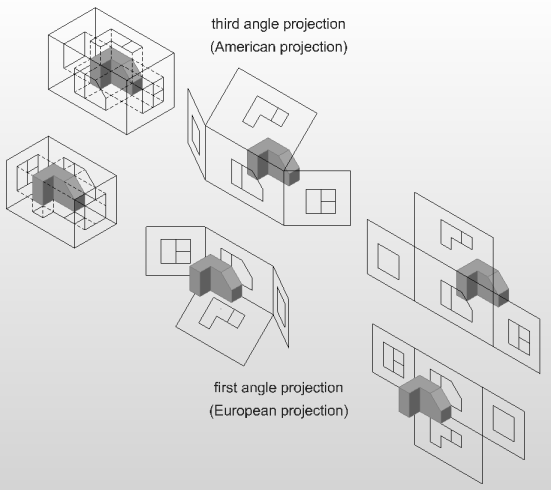

You can choose between first angle (European) projection or third angle (American) projection.

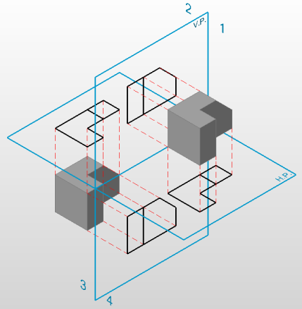

Orthographic projection (or orthogonal projection) is a means of representing a three-dimensional object in two dimensions. It is a parallel projection, where all the projection lines are orthogonal to the projection plane, resulting in every plane of the scene appearing in affine transformation on the viewing surface. It is further divided into multiview orthographic projections and axonometric projections.
Two projection planes, one horizontal (H.P.) and one vertical (V.P.) divide the space in four quarters.
In the first angle projection system the model is placed in the first quarter space (first angle).
In the third angle projection system the model is placed in the third quarter (third angle).
With multiview orthographic projections, up to six pictures of a 3D model are produced, with each projection plane parallel to one of the coordinate axes of the model. The views are positioned relative to each other according to either of two schemes: first-angle or third-angle projection. In each, the appearances of views may be thought of as being projected onto planes that form a 6-sided box around the model.
The projection type is set by the Projection Type option of the ViewBase command or by editing the PROJECTIONTYPE system variable:
0 = First angle projection
1 = Third angle projection
The value of the PROJECTIONTYPE system variable is saved in the drawing.

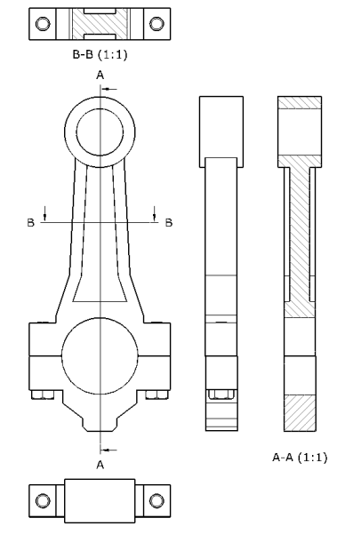

Generating Cross Section Views
A cross section is the intersection of a 3D solid model with a section plane. In technical drawings, the internal parts of the 3D model are hatched in cross sections.
To generate section views of a 3D solid model, run the ViewSection command from the paper space layout where the standard drawing views exist.

Use ViewSectionStyle command to adjust different properties of section views such as:style, color, and height of identifier text
start and end symbols, their colors, size and direction of arrows scale, patter, color, and angle of hatches
color, type, and weight of a line representing a cutting plane
Use the ViewDetailStyle command to adjust different properties of details views such as:
style, color, height of identified text, and the type of identifier
symbol, and its color and size
color, type, and weight of detail view boundary
