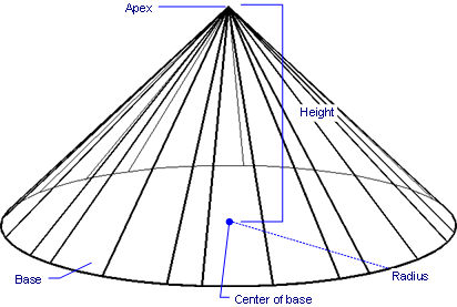

: cone
Elliptical/<Center of base of cone> <0,0,0>:  (Pick a point, enter coordinates, or enter an option.)
Diameter/<Radius of base>: (Pick a point, enter coordinates, or type D.)
Apex/<Height of cone>:  (Pick a point, enter coordinates, or type A.)
Center of Base of Cone
Specifies the center of the cone's base; enter x,y,z coordinates or pick a point.
Diameter
Specifies the diameter of the base; prompts you:
Diameter of base - enter coordinates or pick a point.
Radius of Base
Specifies the radius of the base; enter coordinates or pick a point.
Apex
Specifies the peak of the cone; prompts you:
Apex of cone - pick a point, or enter coordinates.
The point you specify determines the height of the cone, as well as the angle at which it is rotated.
Height of Cone
Specifies the height of the cone; pick two points, or specify coordinates.
