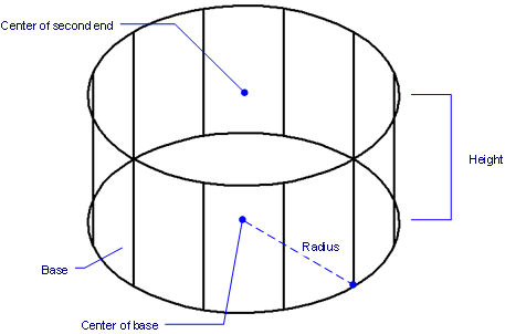

Center of Base of Cylinder
Specifies the center point of the cylinder's base; enter x,y,z coordinates or pick a point in the drawing.
Elliptical
Draws the cylinder with an elliptical base.
First End of Ellipse Axis
Specifies the end point of the ellipse's first axis.
Second end of Ellipse Axis
Specifies the other end of the ellipse's first axis.
Other Axis
Specifies the endpoint of the ellipse's second axis.
Radius of Cylinder
Specifies the radius of the cylinder; enter coordinates, a distance, or pick a point.
Diameter
Specifies the radius of the cylinder; prompts you:
Diameter of cylinder - enter coordinates, a distance, or pick a point.
Height of Cylinder
Specifies the height of the cylinder; you can enter a negative number to draw the cylinder downwards.
Center of Second End
Specifies the center point of the cylinder's other end; prompts you:
Center of second end - pick a point, or enter coordinates.
