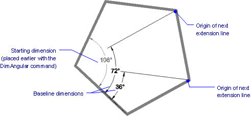

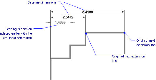

Baseline dimensions applied to a linear dimension
Baseline dimensions applies to an angular dimension
Chooses the linear or angular dimension from which to continue dimensioning. |
Locates the endpoint of the second extension line; the first extension line is co-located with the first extension of the starting dimension. The command repeats this prompt until you press Esc. |

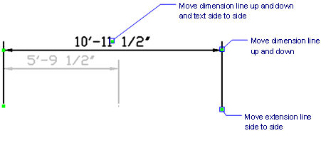

Grips Editing
Baseline dimensions can be edited directly through grips:
Select the baseline dimension. Notice the grips.
Drag either grip on the dimension line to move the dimension line; the extension lines change length.
Drag the grip on the text to relocate it; the dimension line moves along, and a leader line is added, if required.
Drag either grip on the extension lines to move the extension line; the dimension line changes length.
