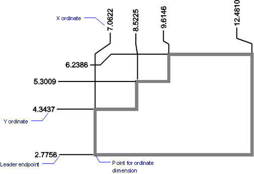

Measures x and y ordinate distances from a common point at the current UCS origin.
command bar: dimordinate
aliases: dor, dimord
menu bar: Dimension | Ordinate
toolbar: Dimensions | ![]()
: dimordinate
Select point for ordinate dimension: (Pick a point.)
Leader endpoint [Xdatum/Ydatum/Text/Angle]: (Pick an endpoint for the leader, or enter an option.)
Dimension text: = xx.xx
The distance is measured from the origin of the current UCS.
Forces the ordinate dimension to measure the x distance; the distance is measured from the origin of the current UCS. |
Forces the ordinate dimension to measure the y distance; the distance is measured from the origin of the current UCS. |
Specifies the angle of the text; useful for keeping text horizontal with inclined dimension lines. Prompts you: Angle of dimension text - specify the rotation angle of the text. |
Specifies the text; useful for overriding the default measurement generated by BricsCAD. Prompts you: Dimension text - specify the replacement text. |
